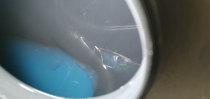

Strange 1 tbh fuel there's fuel comeing threw injector pipes.
But only trys to start on 1 clyinder .
Then suddenly cranks overs like there's no compression ( ie when a cambelt fails ) igition off back on and attempts to start on 1 clyinder
Strange noticed there's air and diesal mixing coming out off injector hpf to injectors . But feed from tank is air free ? I can only assume hpfp
