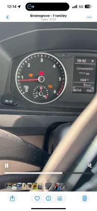

Orange Coil light keeps coming on and goes into restricted performance.
Bi-Turbo 204hp (CXEB) DSG, 4motion, 2018, 42,800mls.
I had orange coil light popping up. Was displaying these fault codes. I had the All In Warranty, so went to my local VW Commercial garage (they sold me the warranty 13 months ago). Apparently, the info that they then got back from Germany was to put a new Bi Turbo system on it, which they did along with 4 pages of parts! Total was approx £6,900 as they broke a stud on the manifold so had to drop the engine. All was covered under the All In warranty.

My turbo failed last year on my way to holiday in France, luckily failing before the tunnel.
so I made it onto Dell Massive's list
got a new turbo then it spent the best part of 6 months in the dealership whilst they tried to fix heating issues related to coolant etc.
problem is I took it out today and the oil light came on, its had 1200 miles since turbo from what I can tell (trip computer) and it took about 3/4 of a litre to get it to mid point on the dipstick.
I assume Im now looking at more issues in time. BIG QUESTION is: do I drive down to France next Friday, 800 odd miles? its 2 stages on the way down then I do one long drive on the way back.
Im OK (ish) with topping up oil but should I be expecting another catastrophic engine failiure?
It took alot of work on my part to get the dealership and VW to do good will on the turbo, in the process they claimed to have looked at DPF region etc, coolant in oil etc because they didn't want to help. but in the end they caved.
so initial question is whether the drive down is risky or not?
its doing to dealer on Tuesday for them to 'take a look'
