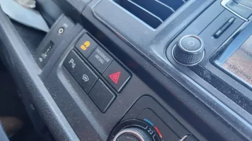

Which is why my S/S is permanently set to 'off' ;)
Mine too. . . .
on the M25 roundabout as we speak. lol.
and normally have the "Oil Temp" displayed . . . always in the 90-105c range.
