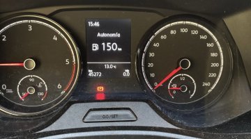

Hi there guys,
I can’t seem to find how to check the ad blue level.
I have a 2022 transporter 2.0l 150bhp, no buttons on steering wheel, bulk standard van. I have done 17.000km since I purchased it from 28.000km with fresh service and I still have no advisory to fill.
Cheers!

Considering the SL instruments don’t shown oil level either, it’s not impossible.
Apparently there’s 2 startline instruments.
One can be coded so big digital MPH shows other can’t.
Mine has the big digital MPH but nowhere scrolling through the MFD settings says anything about the ad blue.
Other than the filler below the diesel filler I’d never know if it had ad blue or not.

I wonder if it only displays when it gets down to 1500 miles & comes up as a warning rather than a selectable display.
I went to my local VW dealer today here in Madrid and they said no way of knowing on startlines. Although I have done 17000km since the last service he said not to worry and that it would flash up when it needs filling up.
He also asked me whether I do a lot of motorway driving which I do 90% of the time so that plays a big part too.
Also was serviced at 28000km and it’s on 45000km at the moment, wouldn’t mind giving it a full service soon, they recommend every 40000km but that seems a lot! I wouldn’t mind doing it every 20000km. ( about 13000miles I think )
