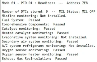

Certainly a good idea to keep on monitoring - to speed up the fault scan you could do engine only:
VCDS > Select Control Module > Engine > Fault Codes > Save Codes
As you have cleared the fault memory I'm curious to see how soon the emission status (PASS) will be restored.
I'm assuming currently it wouldn't pass MOT because of cleared fault memory.
The emission status can be seen as follows:
VCDS > OBD-II Functions > Mode 1-01 Readiness > Address 7E8 > Save
Could you please post the log.
Should be similar as below except not all as "Passed"

@mmi I’ve done the obd 11 thing but when I press save it wouldn’t save it. So here is a photo.D4D24DD0F-AA12-4A2F-953A-EC9ED2E0BF8A.jpeg
Done 16miles twice today.
Also a scan of the engine shows the faults have returned but without throwing an EML.
Edit:- the obd2 data is on the scan log 13 times. Now I know where it went when I kept clicking save.

I have only used vcds twice but looking at the pic above - maybe it won't save because it is still running diagnosis.
:thumbsup: Thank you very much. I'm expecting the "failed" ones to return to "Passed" fairly soon. The fail is because of clearing the fault memory - actually here the meaning is "Adaptation cycle incomplete".

Hi, @mmi just a quick update.
I rescanned this morning and the same fault codes are there.
Also, as you predicted, all the fields have changed to 'passed' in the OBD 11 scan.
No EML though.
