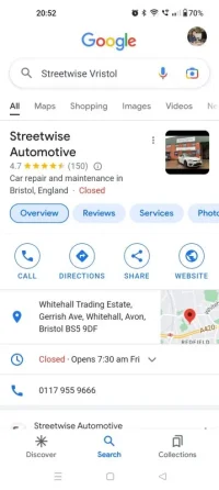

I use streetwise in Bristol as my independent garage they’ve looked after my vws for yearsust wondering would any vw specialist be able to see what’s going on with the Adblue?
Thanks a chippie will hit them up, appreciated, do you happen to have a contact number?I use streetwise in Bristol as my independent garage they’ve looked after my vws for years
Wouldn’t take my van anywhere else especially the main stealers
