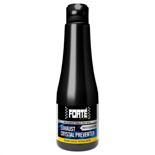

Yeah exactly what I have experienced with the main dealer. Don’t suppose you know what additive they used to stop crystallisation from happening?

will empty half the tank today and head to Halfords to see if I can find any anti crystallisation additive.

I think it was the forte stuff as mentioned by noddy996 but the brand isn’t on the receipt so not 100% sure but they all probably do the same thing. Crazy that they recommend having to add an additive to the Adblue additive . Is your warning still on the screen djgriff or has it gone now? I have read lots of stories about this message but haven’t found anyone that’s actually broken down or engine got to the point of not restarting as a result so hoping if it reappears then it will only be temporary.

Yeah been driving locally and still showing the warning light. Have order 3 bottles of the additional additive to make sure I don’t run out going forward. Seems really stupid to have such a fragile system. Anyway learning the hard way it seems. I managed to remove 1/2 a litre this morning so there is nothin gin the filler pipe. Finger crossed the additive will work its magic tomorrow. Thanks for all the help guys , appreciate immensely and learn a ton
