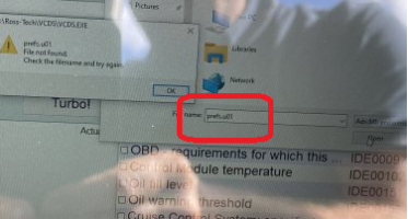

it won’t even do the first one create block map
Please ignore the blockmap for now. Your VCDS-cable is probably an older generation - which just can't handle the current protocol.
The actual test should work though.
On the picture you need to navigate to the folder where you downloaded the setting file (the prefs.u01 is the default).
I think you are stuck here - the file TEST_EGR_DPF....u01 needs to be found in the box below.
Did you remove the .PDF file extension (leave as .u01 extension)?

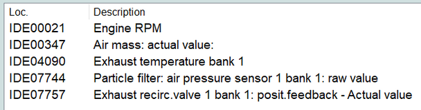

Instead of loading preset file could just tick the following:
I've tried just ticking the boxes but it doesn’t come up in the advertised measuring values any of the boxes I tick
I don’t think my vcds is working properly it won’t even access all the addresses on a auto scan
Sorry to hear that. I guess under Basic Settings it's the same limitation which prevents the VCDS-cable to create the blockmap file.
Yes, not a good sign...
Instead of running the test in Basic Settings, can you make a log as follows
VCDS >Select > Engine > Adv. Meas. Values
- tick the 5 values mentioned earlier
- select Log, Start
- start the engine
- record for 30 seconds
- stop logging, etc.
The log file should be in folder C:\Ross-Tech\VCDS\Logs\...
