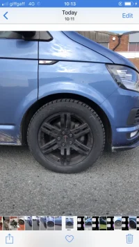

Question for @chriscroft I've been offered a set of 18" Sportline wheels from a local friendly tyre fitter, now waiting for a price for a set of the Nokian Weatherproofs 235/55R18's you recommend on my 2018 T32 Kombi (standard suspension with no intention of lowering). Are spacers definitely required to avoid rubbing? I'd like a set in time but would rather avoid the extra outlay at present.

Someone’ll correct me if I’m wrong, but I think you’ll only need spacers if the Sportline wheels are the T5 version, which’ll foul big brake callipers.
Could Some One Confirm
I don't know for sure with the T5 sportline. Given that 17" devonports clear the larger brakes on the T6 17" chassis; I would have thought an 18" VW T5 wheel would be fine.
The issues would come from the spokes (if any at all) at the point where they meet the inner side of the rim.
But if it did need a spacer maybe 5mm would do it, and they are cheap.

@DaveyB is running sportlines 2 but not sure on spacers and @Deaky is definitely running 5mm spacers on his T5 sportlines because of the spokes catching, i had a talk about it at the weekend
Thanks for the replies, I only saw one of the wheels briefly as they but were shutting up for the day but I'm pretty sure it was one of these
