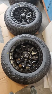

I have Falken Wildpeak AT3Wa in that size and have been fantastic in all weathers so far. Light snow, rain, dry etc all good. Driven on the motorway several hundreds miles too all good . They are not noisy at all really not that I have noticed significantly. Really pleased with them .
