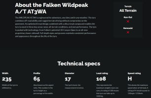

Just seen your post and you got me rather worried (I have a T32 and just ordered the falkens) so I double checked.....
Falken Wildpeak AT3WA have a 108 load rating, needless to say there was a big sigh of relief!
