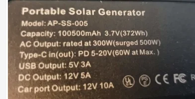

this shows that the two ports on the other side are regulated to give out a steady 12.4V - which is great. (upto 5A max)

so now you can use the RHS ports from 100% - 0% and you will get 12.4v. ( 5A max ) per port.
the 12v socket on the LHS is rated for 10A max . . . . so higher current. but not 12.4v regulated.
