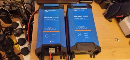

just managed to bag myself another Victron IP22 charger.
30A single output.
UK version so it has a UK plug.
PLus its the newer HW version that has VE.Smart BT buit-in . . . . . happy days.
out the box it was FW V3.21 . . . . after a quick update its now. V3.42
now i have two of these i can double up and get 60A charging on the go (30A +30A)

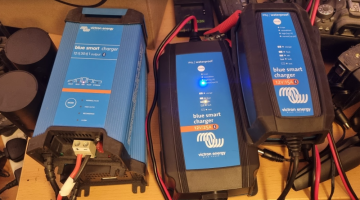

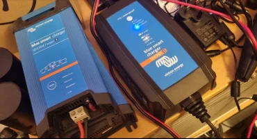

heres the latest charger in the collection.
Victron IP65 12v/25A
its a beast compared to the IP65 12/15A
and even bigger than the IP22 12/30

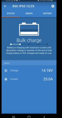

FW update on first connection.

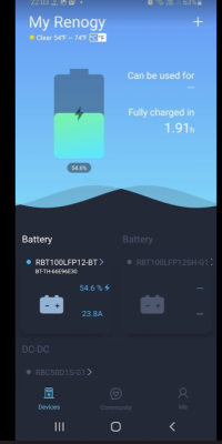

connected to a Renogy 100A lithium . . .
we get 25A straight away. . .
it get warm when running full rate. . . . but not HOT.
its fanless and waterproof too.
but for size, you cant beat the IP22 . . . and its 30A !!

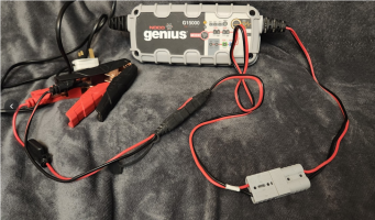

anyone fancey this?
Noco Genius multifunction charger G15000 EU 12V/ 24V 15A for lead-acid and lithium batteries​
