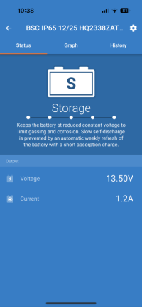

Van is off and locked. Victron IP65 12/25 charger has been connected for about 48 hours now. It correctly moved to Storage mode after Absorbsion charge… but 13.9A !!??? That can’t be right!?

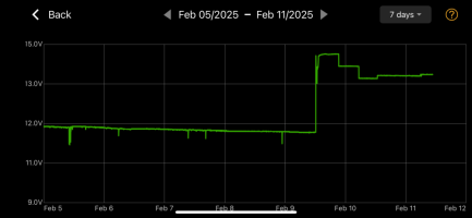

Thanks @Dellmassive.. it looks as though maybe the battery wasnt charged, as it has now (12 hours later) dropped down to ~1.4A.
There are still some interesting anomalies though, and I'm intrigued by your comment about the Leisure Battery. I have a CTEK DC-DC charger, but I thought that was connected to the Smart Altenator, and would only charge the LB if the engine was running (which it hasnt been).
I also looked at the LEDs on the Victron charger, and all of them are OFF, and the MODE button does nothing.. yet I can still connect to it via Bluetooth on my phone!?

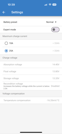

- Battery is the factory AGM starter battery, charger profile is set to 'Normal' with Absorption Voltage of 14.4v, Float 13.8v and Storage 13.2v.
- I have a separate BM2 voltage monitor, and voltage agrees
- Charger is stone cold, but it is outside, and when I checked, current had dropped right back
- Looking at the settings, Bulk charge is time limited to 24h, and Absorbtion charge limited to 8h.

all looks good,
that battery/s wernt fully charged then.
the CTEK d250 has the AUTO VSR feature as i call it . . . where it will switch ON when the starter battery is a high enough voltage.
with mu testing using a Victron charger i couls charge BOTH batteries just by connecting to the starter battery. .
