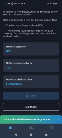

I went with the AGM 115 as it seemed a reasonable upgrade without being too cumbersome to fit. I would suggest doing it yourself and buying a Carista dongle (£25ish) to code it. It’s very simple, would save a few quid and you then have Carista for future problem solving. If you know anyone with a Halfords Trade Card their AGM115 (a rebadged Yuasa battery) is £140. Took me less than 20mins to swap and code. You will need to reset the one-shot electric windows afterwards which takes about 10secs (pull the switch up for 5 secs on each side - done)!
Thanks for the post, I was in exactly the same situation. I've just ordered a Carista dongle and a Varta AGM 096 battery.
In the end I went for the Varta AGM115 battery (80AH and 800CCA). Lots of the local places (ATS euromaster, kwikfit, formulae one etc.) were useless - either tried to convince me "battery does not need coding to AGM, just stick it in and go", or that "we have some diagnostics, not sure if it will work". However... Halfords Auto Centre were great. Basically said they do loads of them all the time, changing to AGM, changing AHs in settings etc. I needed tyres as well so joined their motoring club (as the member discount on the items I needed paid for the annual membership).
The Varta AGM115 battery cost me £187 all in (including fitting and coding), which based on the other prices I had been quoted seemed a good deal to me. +1 for Halfords Auto Centre.
Hi. I bought the Carista dongle and tried to code the new battery, but I can't find the option to change from EFB to AGM. Do I need to pay for the subscription to get this option?
