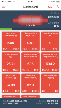

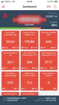

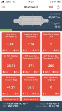

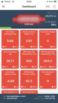

Hi @IWMTom, just had the first regen since using your app and it indicated that the regen had started, but the app was showing less than 30g calculated soot and less than 100%.
Is this to be expected on first use or have I set the app up incorrectly? Van is CXGB engine type and I’ve been using Group 6. Managed to get a couple of pics of how it looked after regen finished.
Many thanks
Ben
Many thanks
Ben
Looks like a previous regeneration had been interrupted and that was the regen restarting. That's what the red timer icon (top left) signifies.
Brilliant thanks for getting back to me, thought it would be something I’d done. I did keep driving till that regen had finished, so clean slate for the next one.
