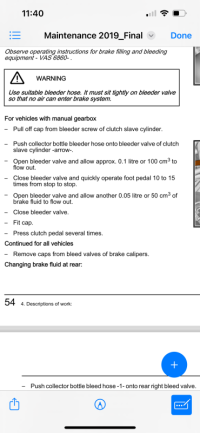

From the manual:
A pre-pressure of 2 bar is required to bleed the hydraulic system.
Open bleeder valves in the specified order and bleed brake callipers.
  • Front right brake calliper
  • Front left brake calliper
  • Rear right brake calliper
  • Rear left brake calliper

Im happy with oil and filter changes. However, I've never done the brake fluid before. I was fairly happy with the process after reading the forums and watching a few videos, however. I've downloaded the manual from the download section and the slave cylinder bleed has thrown me off a bit. I was under the impression you:
1. Remove oil fluid
2. Refill with new fluid
3. Bleed the system by opening each brake calliper bleep nipple in sequence until the oil flows smoothly.
I have ordered a bleed kit so I can pressurise the system and do it by myself.
Can anyone shine some light on where the slave cylinder is and if they have done this before?
I have just had the slave cylinder replaced which cost over £2k by VW due to the GB having the come out which is why I am a bit hesitant.
