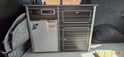

Then the inside pod has sink, hob, fridge and leisure battery in cupboard with a little 4 way fuse carrier (pictured in top right cupboard) and powered with a sergeant ac50 control panel

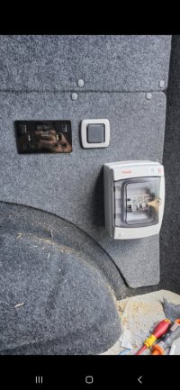

So, as said above, I have the ctek d250sa b2b charger and a sergeant ac50 control panel (see pics) . I also put a 250v inlet port on my van going to a consumer unit and just 1 2g socket (electrician by trade)
