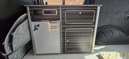

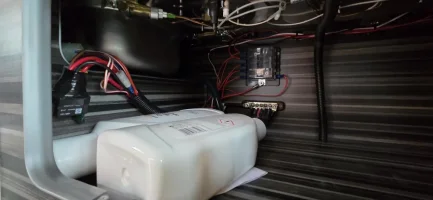

Then the inside pod has sink, hob, fridge and leisure battery in cupboard with a little 4 way fuse carrier (pictured in top right cupboard) and powered with a sergeant ac50 control panel

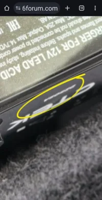

That looks like ctek d250sa?
The SA is the older version
The d250se is the newer version that add a lithium battery charge profile.
That's a 20A ish DC-DC charger from the engine when running.
It also has the ability to have a solar panel connected to it.

Get a better pic of the model number...

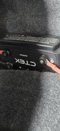

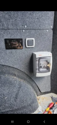

So, as said above, I have the ctek d250sa b2b charger and a sergeant ac50 control panel (see pics) . I also put a 250v inlet port on my van going to a consumer unit and just 1 2g socket (electrician by trade)

If you are installing yourself personally I'd stay away from the all in systems.
They're built for older days of only one type of lead acid battery and non-smart alternators. You'll likely end up disabling most of it in time until it's just a switch panel.
Instead look at decent chargers for each role and an appropriate switch panel. Don't buy anything that's not lithium capable.
Get a good Victron 240v charger in place to support the leisure battery when on EHU.
