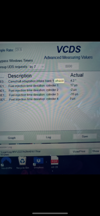

How quickly it changes? On a single journey? Or from a journey to journey? Or from a month to month?
That's what I believe.
An indication of timing deviation - could be timing belt. How old is the timing belt?
In the thread below 6.6 degrees was thought to be reason for a non-starter.
And dont forget the full bsttery reset.. And check all the fuses.
