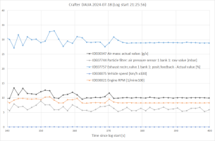

Well, no significant improvement in charge air pressure demand/specified vs. actual - still lagging.
Normed load - to represent driver's torque demand.
PS. The log didn't have the Group UDS by 7/8 request ticked, so the data samples are not very dense in time. It's ok for the above.

Based on the reported values on the log not an issue. Pressure across the DPF seems to perfectly normal, well actually too good - about 6 hPa on hot DPF engine ticking over. Still a leak in exhaust?
Engine ticking over from 371 seconds onwards.
