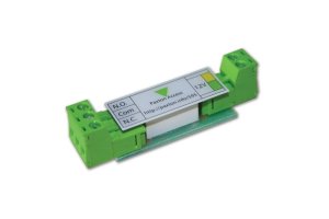

To do this I’ll use a 12v dc handy relay I have kicking about and take a ignition switched supply from the fuse box on the drivers side.

View attachment 168264View attachment 168265
Looks good and especially like the Paxton relay for the ignition switch.
