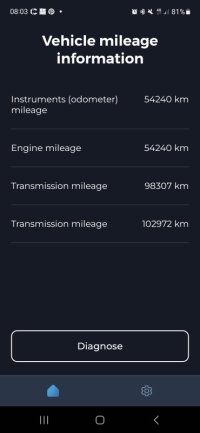

I get that there seems to be this consistent difference of around 4k between the two transmission mileage values, but it is the 44,067km difference between the engine mileage/odometer reading, and the reading for the transmission mileage on my van?
Yes, sorry, was still expanding on difference between two different Carista reported transmission mileage values - that was a question as well but I agree it does not help to figure out why engine vs transmission mileages differ.
Edit: still interesting though and seems IDE03171-ENG102987 is some kind of calculated wear and tear indicator as per Mileage Information Mismatch on Transmission Module, Can Audi's be altered?
Surely that is a big concern/worry when my van is only supposed to have done ~32k miles, but the transmission milage is showing ~60k miles?!

I have documented the evidence that I have collated that points towards some form of clocking taking place with the mileage, as follows:
  • Carista live data - engine mileage ~32k miles vs Transmission mileage ~64k miles
  • OBDEleven (purchased to see if that showed similar figures) - same figures seen for Mileage and Transmission as Carista
  • OBDEleven - total infotainment run time of 3337 hours (would only be an average of 10mph driving when that system has been on, if the instrument odometer of 32k-ish was accurate)
  • Independent local garage who focus on VW (I believe a former VW Master Technician) - also connected to an OBD and saw same figues on the Transmission ECU)
  • Other wear and tear that I'm aware of which may indicate higher mileage - very worn steering wheel which they repaired/refurbished (to average standard) prior to my purchase), partially worn DSG gear knob, noticed that they replaced a seat belt in pre-sale inspection, heavily stone-chipped front bumper which they sorted/resprayed prior to my purchase.
  • During phone call, advised that it had been driven 11k miles in first 10 months that previous owner had it. He had it a total of 53 months, which at that rate, would give rough mileage of 59k. They try to explain this due to Covid/lockdown, but even assuming it wasn't used for 6 months, that still seems a big discrepancy.
  • Finally, after some further driving of the van, I have rechecked the engine and transmission mileage figures in Carista - all had gone up by the same amount after driving 180km, give or take a km on one figure, so that rules out the possibility that the transmission mileage was just going up more quikcly than the others.

Thoughts? Am I wrong in thinking that it is far more likely than not that my van has either been clocked or had a mileage blocker used?Screenshot_20231116_093335_Carista.jpgScreenshot_20231110_080332_Carista.jpg

I checked my van with Carista today, both values are exactly the same. From what you say they are spouting BS.

The DSG can tell when it was build - separate dates for mechatronics and transmission. Do they match with van's build date?
Possibly under OBDeleven live data:
- Mechatronics identification​
- Production data transmission​
