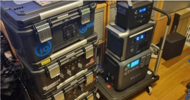

i think im up to about 7 portable power packs now.

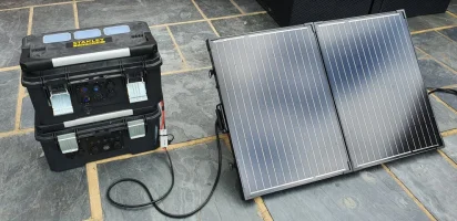

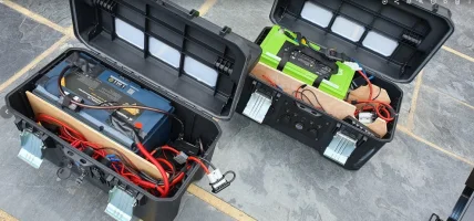

and don't forget you can also build your own battery box too:

Check @Dellmassive ’s thread ‘How I done it’ for battery box ideas.
