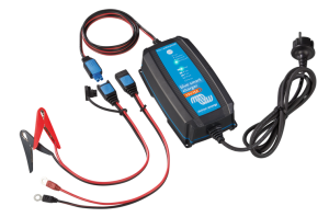

might be worth a look... i have this under the drivers seat Victron 240 v / 12 v / 30 A smart Blue Smart IP22 Charger - Victron Energy
This is also a 30 A 12v power supply unit Step charges your 200AH AGM battery and storage Mode or runs the whole 12 v system so wont really drain your leisure battery while hooked up. it has blue tooth's to your phone app has a night mode and stays cool. you don't even need a battery if you only use hook ups.
Heres the Data sheet = https://www.victronenergy.com/upload/documents/Datasheet-Blue-Smart-IP22-Charger-180-265-VAC-EN.pdf
and a good price from Travelvolts

Yep, I was just looking at the 15a version of it. They do a IP65 version as well but it’s more expensive and a 10a IP65 is pretty much the same price as a 15a IP22. Not planning on sticking it out in the rain...

This is what we have: Blue Smart IP22 Charger - Victron Energy 15A should be plenty for an overnight charge but you can go bigger. Also, make sure you buy a charger that has a Lithium charge profile as you could well end up down that route in the future. :thumbsup:
Victron make some nice kit so you can get the family of products for your charging needs. Blue smart versions work with the Victron Bluetooth app too.

Thanks Dilbert. Yes, I did think about the whole li-ion compatibility thang. Going to pull the trigger on the IP22 15a like yours. Thank you everyone.
I have a 15Amp Victron. I use it purely as a mains charger but lots of folk use it for the hookup. It is waterproof so can be installed under the bonnet if required. It is a multi stage charger so will act as your trickle charger for now and can then be transplanted to the van at a later stage if required. I connect to my starter battery and it then charges both starter and leisure via the DC-DC charger.
