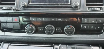

Thanks for you input but you still didn't manage to discourage me(or to change my mind:whistle:) to proceed with VW OEM DCC system.
Let me be clear, I am very open to alternative options even though I already bought some components.
It looks that I will get it done below €500=£422 as I will save few extra quid on the wiring which I am doing myself.;)
Huge and difficult jobs are my favourite.
In deed the system is connected to CAN bus and has 3 driving modes selectable by the console switch.:)
