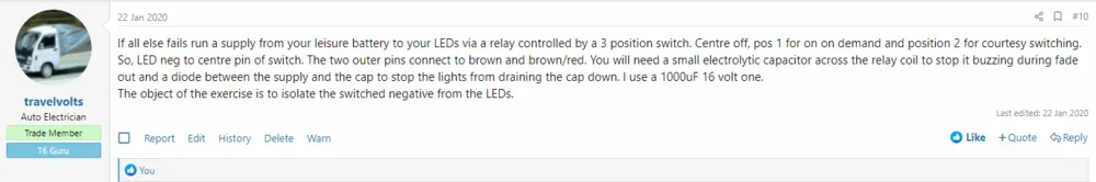

If all else fails run a supply from your leisure battery to your LEDs via a relay controlled by a 3 position switch. Centre off, pos 1 for on on demand and position 2 for courtesy switching. So, LED neg to centre pin of switch. The two outer pins connect to brown and brown/red. You will need a small electrolytic capacitor across the relay coil to stop it buzzing during fade out and a diode between the supply and the cap to stop the lights from draining the cap down. I use a 1000uF 16 volt one.
The object of the exercise is to isolate the switched negative from the LEDs.
You can avoid the relay buzzing and the faint glow of the leds issues by using a MOSFET switch module instead. I have been playing with a combination of a suitable MOSFET switch and a remote switch/dimmer module as someone was looking to do this before Xmas, and the right MOSFET module arrived today. Took a while to find one that had the input completely isolated and which switched the negative supply line output so I could parallel it up with the Dimmer unit, (also a MOSFET switch) but I've tested out in the van today and all seems to work ok. As the MOSFET switch was only £2.75 it's at least as cheap as a relay. And as it's a MOSFET switch the LEDs dim and brighten in the sme way as the van Courtesy Lights do.
