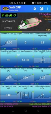

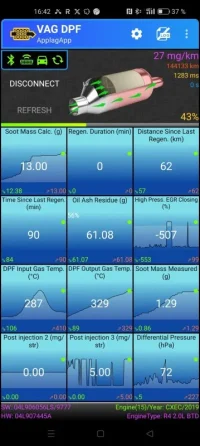

Hello!! After reading the entire thread about DPF issues, I still have some doubts. My vehicle is a T6 199hp DSG 4Motion, year 2019, with 90k miles. I monitor the regenerations with Carista and VAG DPF, and it performs them approximately every 300km. I don’t have any warning lights on or errors, but there’s one detail that worries me: the "Oil Ash Residue" level. I think it’s alarmingly high at 61g and 56%, and I believe this is causing high fuel consumption.
What is the lifespan of this before it triggers a failure? 70, 80, 90? Every time I drive, I see that it inevitably increases, and the soot regenerations don’t lower it. Would it be advisable to have it cleaned before it gets clogged, or should I consider emptying it?
I’m attaching a screenshot at 2000 RPM in 6th gear in case anyone notices anything unusual in the readings.
Next to impossible to say anything useful without knowing a lot of other parameters - air flow, EGR position, engine load, boost pressures, etc.
I'd like to propose to use VAG DPF to monitor the following (screenshots perhaps)
  1. Cold engine ticking over - to capture low end value of DPF differential pressure reading (normally would be less than 10 hPa)
  2. After a journey (DPF input temp about 200-250 °C) - to capture "normal" reading (should be less than 20 hPa)
Note: the values depend on the soot level.
Anyways, it seems that the (1) was perhaps already captured? The recorded low was 5 hPa on your journey. The maximum 227 hPa.
