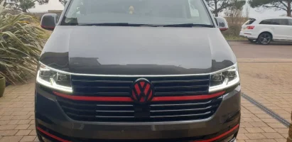

Got the grille and red trim from VanstyleLooking Nice!
Where did you get the red trims from Jonesy68?
Annoying thing is I don't really get to see them myself...Finally got round to fitting them. Thanks for your help @VioletVW. Really pleased with them. View attachment 191111
