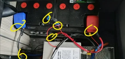

Fitted a BT battery monitor to my leisure battery today, just loosened connectors, slipped in wires and retightened. The monitor is displaying fine. However now have no display on the sergeant ec160 unit and no leisure electrics ? My Ctek 250dse is still showing as charging LB when engine running. Checked the little 15 amp fuse , it appears fine. Any advice appreciated.
Plug van into ehu and Sargent display comes on , switch off ehu and display goes off. So I'm guessing no power coming from leisure battery for some reason ? Even though it's 12.7
Double check those main battery connections.(Leisure battery)
And those fuse holders.
Something may be loose or come disconnected.
Thanks for the help , was a loose battery terminal connection , hate those quick release connectors. Thanks for the help Dellmassive !! Now I just have to find why the battery goes from full to half empty, with nothing apparently on, in just two or three days ?
