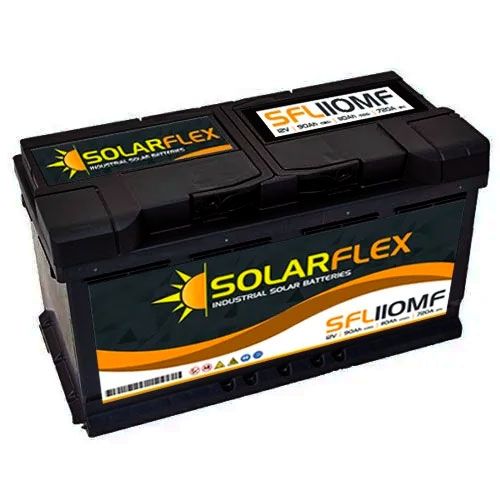

And your battery type?

That's a new brand on me but looks like this one:
It doesn't look ideal as a leisure battery as it is described as suitable for high drain solar backup and based on a starter battery.
From the datasheet it's a standard battery so 14.4v charge
