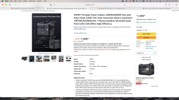

Lots of threads about the Ecoflow but has anyone tried any other manufacturer? - ie. Anker, Bluetti, Aferiy. I think the eco is the only one with an app so is this why its so popular or is it better than these others?
I had the Jackery 1000w which I swapped for the Ecoflow Delta 2. Upside is it has an 1800w output and can charge at up 1200w. The app is great making it more functional ie change charging speed turn the USB,AC sockets innit off Uber the web. .
