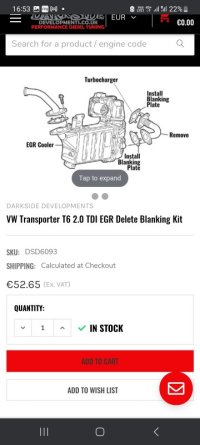

For the newer model it has to be removed via ecu remap and you can buy the blanking plate kit from Darkside Developments.

Thanks for the help guys. I have had it mapped out now, just got the blanking to do. Doesn't look as straightforward as the old egr, has this had are 3 feeds ? 2 rubber pipes and 1 feed from side of block.
I'll get on to darkside
Some people have reported that the blanking plates supplied by Darkside are thick and difficult to fit. There are plenty of options on Ebay.
After checking darksides website, the kit doesn't contain anything for the water side of things.
Am I being really stupid here what happens to the water side as my cooler is leaking.
You don’t need to do anything with the cooling, just make sure the blanking plates go direct to the cooler if possible then if there is a coolant leak into the EGR plus a split pipe you won’t loose coolant.
