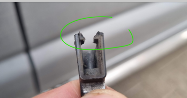

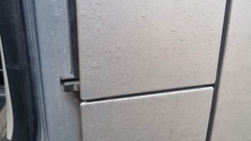

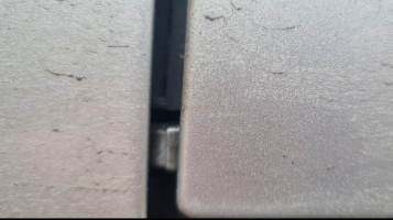

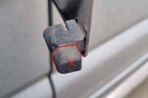

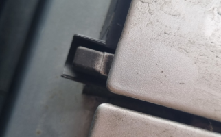

but its slightly destructive.
you need to break the black plastic tab, that keeps the door shut behind the passenger door. . . or ping it off.
its replaceable. . . but you need to cut it WI though damaging the door or flap . . or lever it off.
once that plastic tab is removed the fuel flap will open, with the passenger door still closed.
1661076867148.png1661076945900.png1661076936862.png1661076926816.png1661076919448.png1661076908621.png1661076900811.png1661076892565.png
Yeah that's what I'm thinking. Going to try this shop for a small saw. Our ceramic bread knife won't cut it... At least my family has a sense of humour...
or get a pick in to unclip the black bit from the mounting.
you might be able to get a wedge ( flat blade screwdriver ) (with tape to protect paint work?)
in here to try and pop the clip off . .
well done. . . .
we got there in the end.
