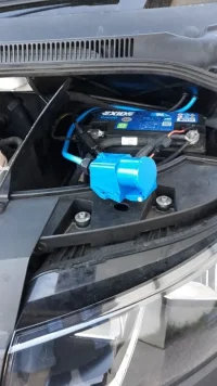

Mine lives under the bonnet along with these other ones above. Definitely recommend it near the battery. Keeps it clean and the bonnet will still close with the cable hanging down.

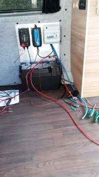

the fuse board lives under the passenger seat.
