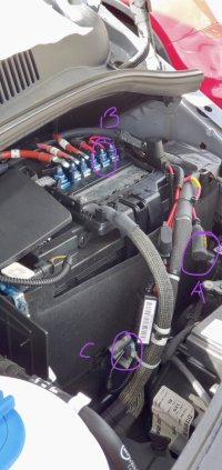

When parked up on the drive at home, to keep my Birchover’s starter battery fully charged, I now hook it up to a CTEK MXS-5 battery maintainer most of the time. I’ve discovered that this will also keep the leisure battery fully charged as the CTEK’s output will switch the VW split charge relay and allow charge through to the leisure battery. The picture below shows the CTEK connector (A) and connections to the starter battery (B) and vehicle earth (C).
