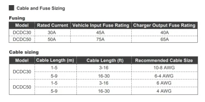

@Dellmassive Are the renology the current go to on DC-DC I would go for the 30 I think and limit the charging to 20 so wiring was kept the same, I have 200W of solar.
Yes - it the ctek d250 charge profile as witnessed in testing here --> [Guide] DC-DC Charger (for leisure battery) -- How I Done It --
I have the Renogy dc50s with the BT module.
I set mine to current limiting at 30A.
And use separate Victron mppt for mobile solar.
For that battery I'd recommend getting the 50A charger now and setting current limiting to 20A untill you can swap out the feed cables and fuses for 50A rated kit.
