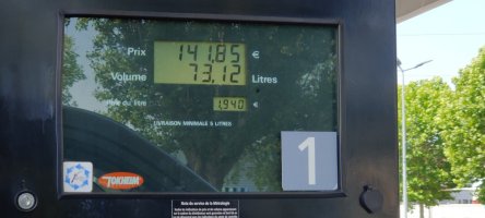

Tank won't be empty, even when range is showing as zero (you probably have 30 to 50 miles range left at that point). If you got 73L in, it's deffo not a standard 70L tank - not unless it was p!ssing down the side of your van whilst filling.I specced and paid for an 80L tank.
I've just filled up the tank from having only 10 miles left and I was only able to add 73.49L.
Is this really an 80L tank?
Surely I'd be filling up closer to 80L?
Confused...
Definitely wasn't pouring outTank won't be empty, even when range is showing as zero (you probably have 30 to 50 miles range left at that point). If you got 73L in, it's deffo not a standard 70L tank - not unless it was p!ssing down the side of your van whilst filling.![]()
Almost certainly a deliberate ploy to try and avoid you running the tank dry and incurring the expense/inconvenience of having to bleed the fuel system of air.Definitely wasn't pouring out
That's good news then. Odd that the sensor is 6 litres or more out.
