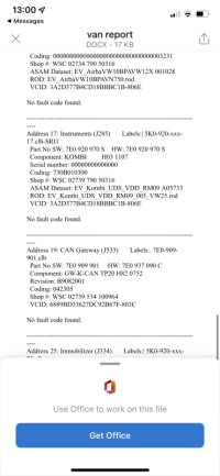

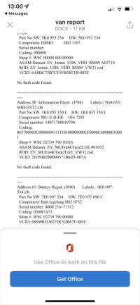

I have volume/skip buttons etc working on wheel, horn also a works however I can’t seem to code in for cruise control in the engine module, I keep facing an error code that is ‘coding rejected, error 22 conditions not correct or sequence error.
I believe I have the correct cable (hex - v2) on VCDS latest version 22.3.1

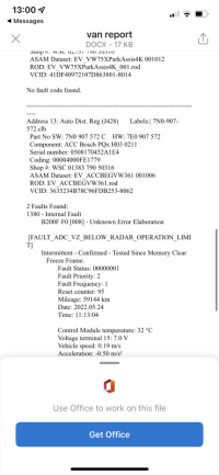

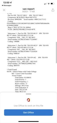

I have attached a VCDS scan report which states a low voltage fault? Could this be the issue? And if so can the fault location be narrowed down via the report?
So close now! any help is greatly appreciated
Did you buy the kufatec kit in the end?
You have brake assist by the looks of it, have you coded the brake module so its aware you now how cruise control? Have you checked all your wiring connections and coding
I haven’t coded any brake module no. I do have radar sensor on the van, do you know how I would go about this?
My wiring all appears okay, maybe I need to take all apart and investigate if the brake module coding doesn’t work?
