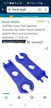

But.... you need the tool to get them appart...... that where most people get issues with the MC4 conections.

Oh I see...that's probably why I struggled...

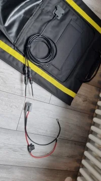

I was going to basically add the Anderson block on the bare cables above...
I'll look into the tools need for the MC4 connection... Would the Anderson block do as a temporary or not advised?
Is there any issue with sticking the Anderson connector on the end of these?
No issue physically... you can fit an anderson onto those solar mc4 cables..
But ... conections should be foolproof. Not just for you after a few beers at a campsite.... but also for anyone else, who might not know what they are doing, and just randomly plugging things in.
Ie solar side = use mc4.
Power side = use andersons.
That way there is no possibility that someone could plug something in incorrectly... which is a fire risk, so a Saftey concern IMO.

As a temp measure sure... it will work.
But id look at swapping the connection over to mc4 at your earliest convenience.

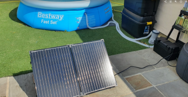

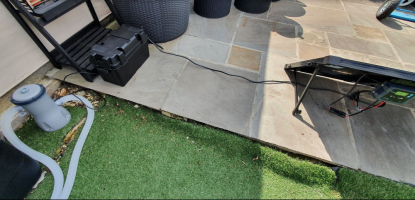

this is my 100w Renogy suitcase in its current role. . . Solar powered swimming Pool.
its running the pool filter pump...

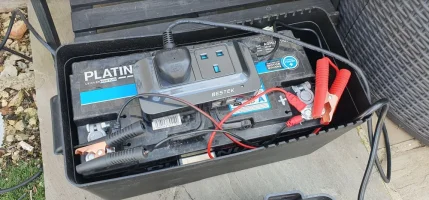

its connected to a SLA AGM battery in the battery box. . . . which has a small inverter thats running the pump.
