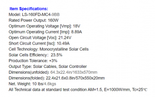

I went for the 160w from Lensun in the end and paid a little extra (£30) for the 3-panel version (rather than 4 panel) to take up a little less space.
Specs for the panel are below:

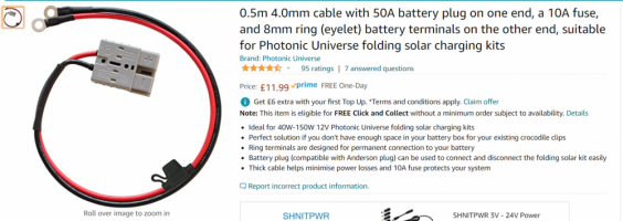

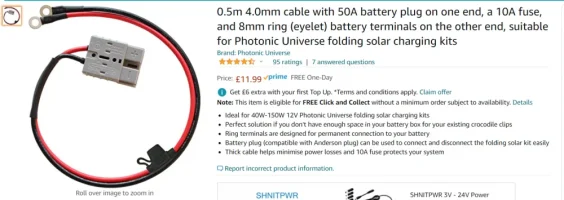

Have purchased one of these to connect to the Renogy DC-DC, 4.0mm cable which if I understand correctly is good up to 39A. Max charging amps of the Renogy Solar input is 25A and if I understand correctly the most i can expect from the panel is 8.89A in ideal conditions.

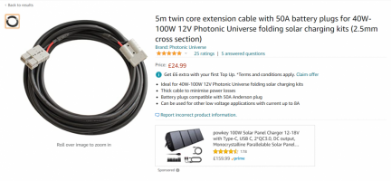

Question, will this extension be OK or do I need something a bit thicker??
The panel is 160w, this suggests its good up to 100w...It's 2.5mm so rated for 28A, yet the description suggests applications up to 8A...is that because they have calculated for voltage drop?? Am I ever likely to exceed 8A...does anyone actually achieve the optimum test ratings in a real world scenario?
OR should I be airing on the side of caution and finding a thicker cable??
