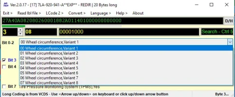

And if I look at the long coding helper I get this drop down list for Bit 0-2.
So I'm thinking that changing this would alter the wheel circumference? I don't want to screw anything up though, so has anyone else done this recently and seen the same result?

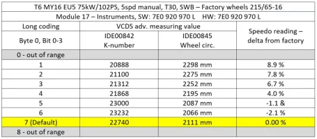

Yes you can alter this. But be aware this can only be altered from a lower to a higher variant. It's irreversible!!!

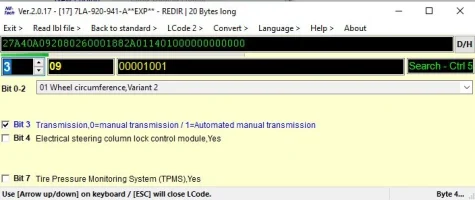

Hit 'Do It!' and I get this error.
My first guess is that variant 2 isn't compatible with my van and I'll just have to move onto variant 3, 4, 5 etc. until I find one that is accepted. However I'm a total newb when it comes to VCDS, so I chickened out and left it alone. Thought I'd come back here and get some more experienced opinions!

When I looked at the long coding helper I could see my wheel circumference was set to variant 1 - makes sense given the 16" steels are probably the smallest wheels fitted to the T6.1 out of the factory.
So with my 275/40/20's fitted, the speedo is reading ~4mph low at 70mph (speedo = 66mph, measured GPS speed = 70mph) which is pretty much in line with what willtheyfit.com tells me.
Now the scary part. There's plenty of evidence on various forums and in this thread that changing the wheel variant on the new T6.1 platform is a one-way street. i.e. you can increase the variant but not go backwards. So my approach was to increment the variant one step at a time, hoping they scaled in a relatively linear fashion.
Step 1 - set to variant 2. Coding was rejected (Request out of range).
Step 2 - set to variant 3. This time coding was accepted, and my IDE00845 values were increased to 2111mm / 2195mm respectively.
A quick test drive confirmed my speedo error was reduced to about 2-3 mph.
Step 4 - set to variant 4. Coding was rejected (Request out of range).
Step 5 - set to variant 5. Coding was rejected (Request out of range).
Step 6 - set to variant 6. Coding was accepted, and my IDE00845 values were increased to 2195mm / 2294 mm.
Another test drive and now my speedo is pretty much bang on. At this stage I was very happy to call it quits. Whilst I could have tweaked it higher so that the speedo reads a little higher than actual (as is common practise), I wasn't willing to risk a large leap in circumference knowing that I couldn't revert back. Incidentally I did try going backwards just to verify, and can confirm you get 'Coding Rejected Error 22' which prevents you from doing so.
