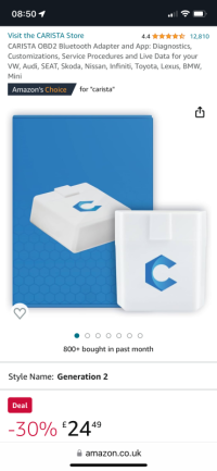

I’ve managed to get hold of some H7’s. Is there anyone in Staffordshire around the Rugeley area who has access to a VCDS that could help me with the coding to keep the dipped on with main and possibly turn off the DRL when indicating?
Thanks in advance.
Buy yourself Carista and you will be able to do it on there. There are not much money and useful tool to have to do other sublte changes and monitor dpf too
Cool. Any particular sort I need. And where would I look. Just google or eBay?
I got mine from amazon, looks like its on sale, you can also get a free months subscription.
You used to need to download the 'beta' version of the app to get the option to change the light settings but don't know if this is now on the normal one. I did mine H7 THQ lights about a year and a half ago using this method
They're the ones, I think @ginkster went the same way too, didn't fancy LED's in main and dipped due to potential MOT issues etc.
Yep, that’s what I went for too. I’ve had the DRLs for about a year now and they have been perfect. Passed MOT fine with them too.
Just search Carista on Amazon. They are reduced at the moment to £24.49 (though they were even cheaper a year ago!!). Sign up to the Beta program and the keep dipped beam on setting is in there.
