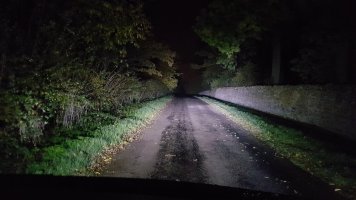

IMHO, Yes is the answer to your question (with the same standard halogen bulbs in both). But as @Stay Frosty and @dubber36 are politely discussing this is a pretty subjective assessment so as they say "your mileage may vary'.I went for the H7's because I just wanted a better dipped beam. I know H4 have same 55w but my H4 with 200% Osram bulbs are still terrible, will the H7 beam be much better?
Yes.I went for the H7's because I just wanted a better dipped beam. I know H4 have same 55w but my H4 with 200% Osram bulbs are still terrible, will the H7 beam be much better?
If you can find a set cheap on eBay or elsewhere its a cost effective upgrade to the standard H4's.
If you have them, then fit them!I have a set sat in a box in the garage, just contemplating whether or not to fit them, having to go and spend another £50 on two twin pack Osram 200% bulbs.
