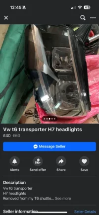

Good luck whoever gets! Great price. My saga on headlights ended thanks to this forum. Drove back from lakes today, much happier with h7!!
Excellent.
I’ve got a set of H7’s in the garage that I’ve fitted all brand new bulbs into. Osram nightbreakers 200% just waiting for some other bits that I want to fit at the same time I have the bumper off to save taking it off twice.
But……. I keep looking at these THQ ones and think should I shouldn’t I. @Pewt has thrown a massive spanner in my works with his HID THQs.
I want that one…..
