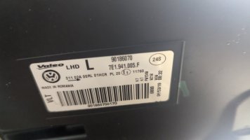

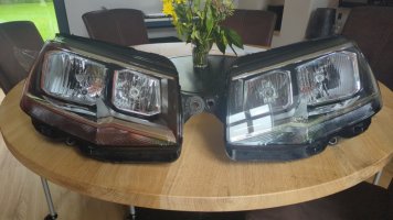

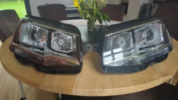

These are the H7 headlights 7E1.941.006.F
Final check, these will fit my T6 TSI 2017 with OEM H4 lights?
Pretty sure they are plug & play, but just wan to make sure they fit.
I finally got myself a set, seller is about to ship them. Just a quick check with the folks here;

They are Plug and Play, but you’ll want to code the dipped beam to remain on when main beam is activated.
Marked as left hand drive though.Hi!

Correct! I am in the NetherlandsMarked as left hand drive though.
