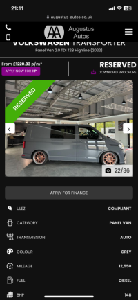

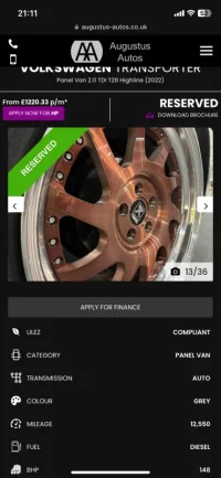

Can I ask what size wheels & tyre dimensions are you running here? Looks great.
Bilstein NSL coilovers
Navis Ludis 20" x 9" 9J ET42
Lanvigator Catchpower PL 275/35Z/R20 102Y
Sadly I can't recommend the setup for anything other than looks. Practically it stinks.
The ride is harsh and unforgiving and the low profile tyres can't deal with potholes. Also the Lanvigator's weight rating is too low for my T32.
I bought the van for long-term travelling so added an underslung water tank, jacked up the coilovers and am soon to change the wheels and tyres for 17" steels and four season tyres
Realising that I've not done a great selling job here... I am about to sell the wheels and tyres. They are in showroom condition and have done a total of 300 miles. I'm in East Sussex, UK if anyone has any interest.

If you havent already purchased the 17" Im on 18" with load rated 103 tyres for my T32 if you want to try something different. Im on Solows at their heighest (Im in Surrey)
Thanks. I haven't purchased the yet as the 17" steels are out of stock. However there are 18" steels in stock so am interested in your experience. I had assumed that 18" would not give me sufficient cushioning effect, hence drive for 17".
Can I ask what wheels and tyres you use and how you find the ride?
I'm on 'Not So Lows', not 'So Lows' so I guess my van is probably higher than yours? Mine is at the highest drop of 65mm (although front is a little lower).
I don't suppose you have a photo to hand (comfort and practicality is my main thrust but I would like the van to look good too)?
