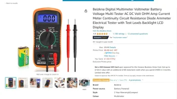

you 100% defo need a multi-meter to test for 12v or battery voltage everywhere.
visual inspection is great. . . .but you need a meter to prove power is at the fuses etc.
Amazon same day / next day?
under £10
