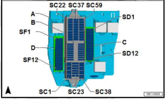

I really wish I could tell what the issue is. Anyway has to be something regarding major supplies, grounds or databuses.
I guess I would first check the ground points at under seats, the easy ones at left and right A-pillar bases and the nasty one somewhere at the center channel from gear stick to between the front chairs.
The big wire lump that goes in the floor channel to under the seats and then under the van rings many of bells in the fault list. But not all. So indeed searching for the screw from that area might have moved the wires just enough to reintroduce the issue. Reverse could be also true so just lifting the wire lump a bit from different positions, putting some lego bit under and cycling ignition might make everything work suddenly - doing this repeatedly in various positions could help to point out the location.
Then maybe systematically pulling fuses, one by one, from the main fuse box and seeing if the amount of faults could be reduced or changed that way might be a tedious way to narrow down which circuit the issue is within.
I’ll try to browse wiring diagrams to see if I can come up with further ideas. At this point though I don’t unfortunately have any more specific advice to give - I really hope you find the issue and it turns out to be something simple. And probably it is something simple but finding it may take lot of work.
One specific thing that caught my eye from the scan is the very low Terminal 15 (ignition on) voltage reported by the steering angle sensor.
Maybe a clue
