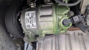

Mine was ice cold, then it suddenly wasn't! My local indy garage found that the AC pipe from the front (near the radiator) has a small hole which looks like it's chaffed on something else so it's lost pressure and no longer works. Anyone else had this? It's not cheap or easy to replace - quoted £480 for parts and labour!!!
